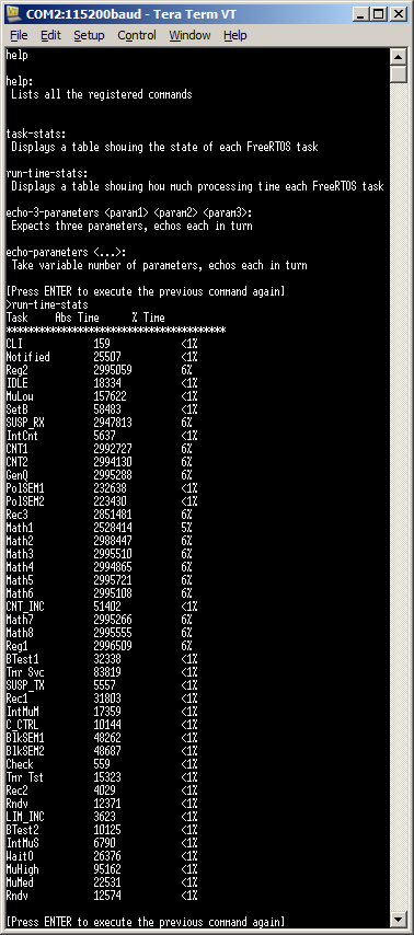

An example CLI session
main_full() creates a comprehensive test and demo application that demonstrates:
Connect to FreeRTOS-Plus-CLI though the USB connector marked "USB UART J6" on the KC705 board. The USB port will enumerate on the host computer as a COM port called "Silicon Labs CP210x USB to UART bridge", which can then be connected to at 115200 baud using a dumb terminal such as Teraterm, or HyperTerminal. Type 'help' in the CLI to see a list of the registered commands.

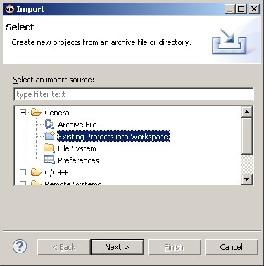

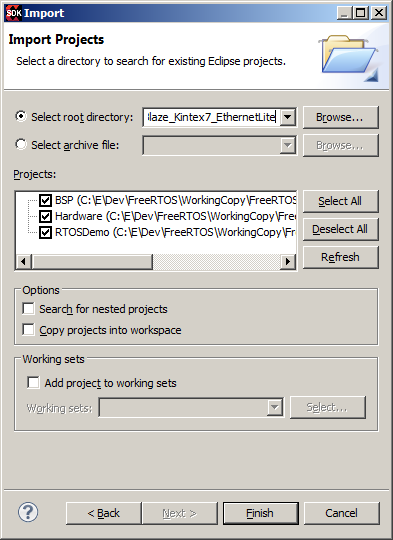

To import the Xilinx Software Development Kit (SDK) project into an existing or new Eclipse Workspace:
  1. Select "Import" from the SDK "File" menu. The dialogue box shown below will appear. Select General->Existing Project into Workspace, as shown in the image.
Importing the Xilinx MicroBlaze RTOS demo project into the SDK
The dialogue box that appears when "Import" is first clicked 2. In the next dialogue box, select /FreeRTOS/Demo/MicroBlaze_Kintex7_EthernetLite as the root directory. Then, make sure the RTOSDemo, BSP and Hardware projects are checked in the "Projects" area, and that the Copy Projects Into Workspace box is not checked, before clicking the Finish button (see the image below for the correct check box states).
Importing the free ARM Cortex-A9 RTOS Demo Source project into the Xilinx SDK
Make sure all three projects are checked, and "Copy projects into workspace" is not checked 3. Once all three projects have been imported, the project explorer window of the SDK IDE will appear as below.
The Hardware and BSP projects are dependencies of the RTOSDemo project, so only the RTOSDemo project needs to be built explicitly.
The MicroBlaze KC705 RTOS projects viewed in the Eclipse project explorer.
All three projects imported into the workspace

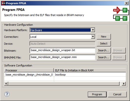

Programming the Kintex FPGA
The Kintex FPGA must be programmed before the application can be downloaded to the MicroBlaze softcore microcontroller. This step only needs to be performed once on each power cycle.
  1. Ensure the KC705 hardware is powered up and connected to the host computer using its JTAG USB connection.
  2. Select 'Program FPGA' from the IDE's 'Xilinx Tools' menu. The Program FPGA window will appear.
  3. Configure the Program FPGA window as shown below before clicking "Program". The base_microblaze_design_wrappers files are located in the Hardware project within the workspace.
programming the Kintex FPGA ready to run the RTOS demo on the MicroBlaze
The configuration necessary to program the Kintex FPGA

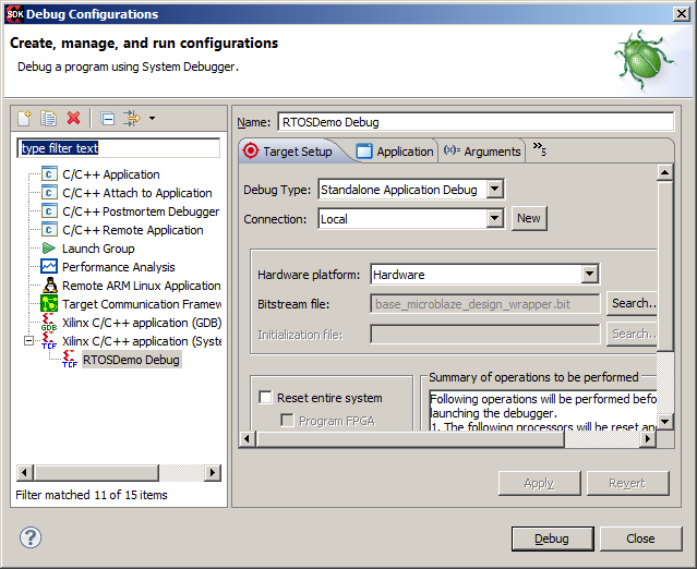

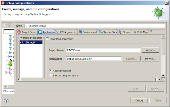

Starting a debug session
  1. Ensure the Kintex FPGA has been programmed as described above, and is still connected to the host computer using the hardware's JTAG USB connector.
  2. Select 'Debug Configurations...' from the IDE's 'Run' menu. The Debug Configurations dialogue box will appear. Double click 'Xilinx C/C++ application (System Debugger)' to create a new debug configuration. Note: Use the GDB option in place of the System Debugger option if you intend using the FreeRTOS kernel aware state viewer plug-in.
  3. Configure the 'Target Setup' tab as shown in the image below.
Kintex FPGA MicroBlaze RTOS target setup tab
The required settings on the Target Setup tab 4. Configure the 'Application' tab as shown in the image below.
Kintex FPGA MicroBlaze RTOS application tab
The required settings on the Application tab
All the other tabs in the 'Debug Configurations' dialogue can be left with their default settings. 5. Click the "Debug" button to commence debugging. The application will be downloaded to RAM and the debugger will break on entry to main().
