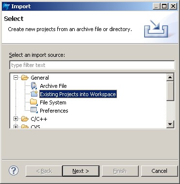

  3. Select "Import..." from the Eclipse 'File' menu. The Import dialog box will open.
  4. In the Import dialog box, select "General->Existing Project into Workspace". The Import Projects dialog box will open.

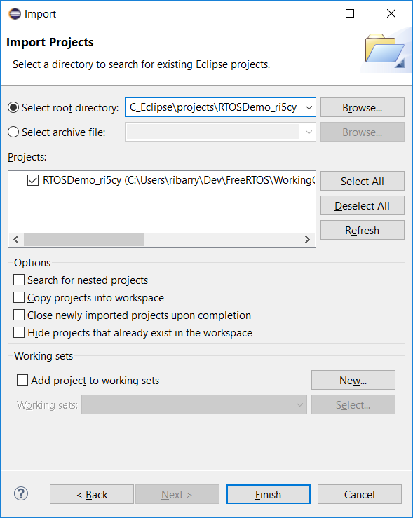

Importing an existing project into the workspace 5. In the Import Projects dialog box, navigate to and select the FreeRTOS/Demo/RISC-V_RV32M1_Vega_GCC_Eclipse/projects/RTOSDemo_ri5cy directory, and ensure the 'copy projects into workspace' check box is not checked.

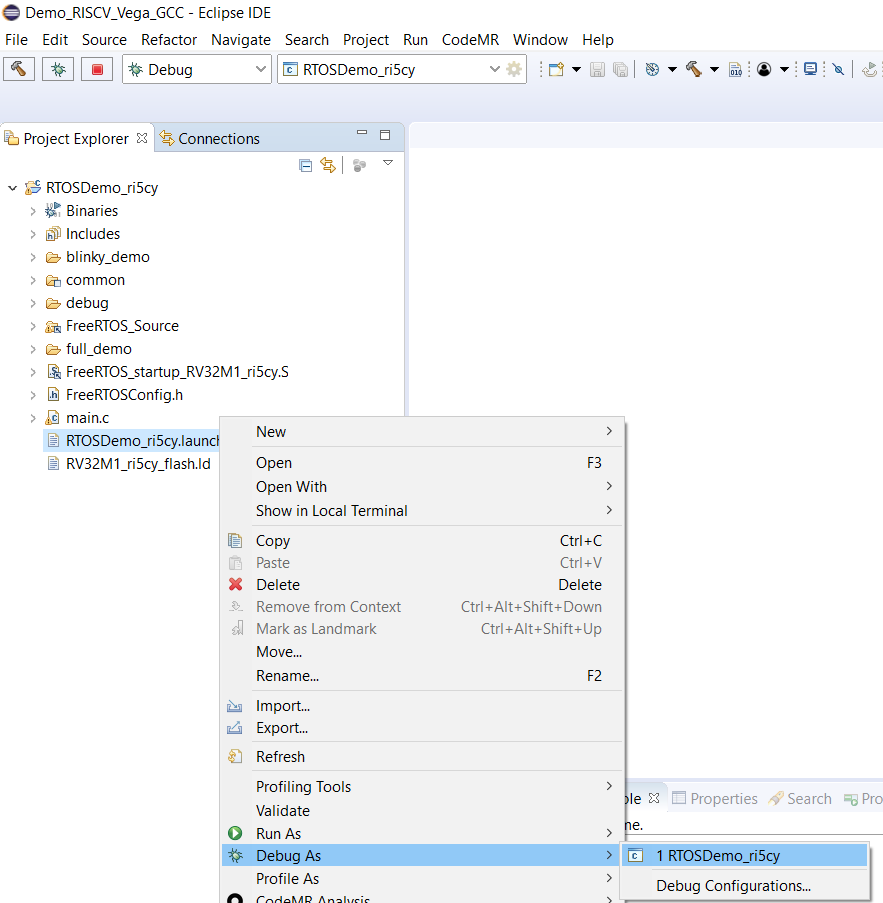

Selecting the directory and project in the Import Project dialog box. Click to enlarge. 6. In the 'Projects' window of the Import Projects dialog box, select the RTOSDemo_ri5cy project, and click finish. 7. Select "Build all" from the Eclipse 'Project' menu. The project should build without any errors or warnings, and output a file called RTOSDemo_ri5cy.elf. 8. Finally, to start a debug session, right click the "RTOSDemo_ri5cy.launch" file in the Eclipse project explorer, then select "Debug As->RTOSDemo_ri5cy" from the pop up menu.
Selecting "Debug As->RTOSDemo_ri5cy" from the pop up windows after right clicking "RTOSDemo_ri5cy.launch". Click to enlarge.
